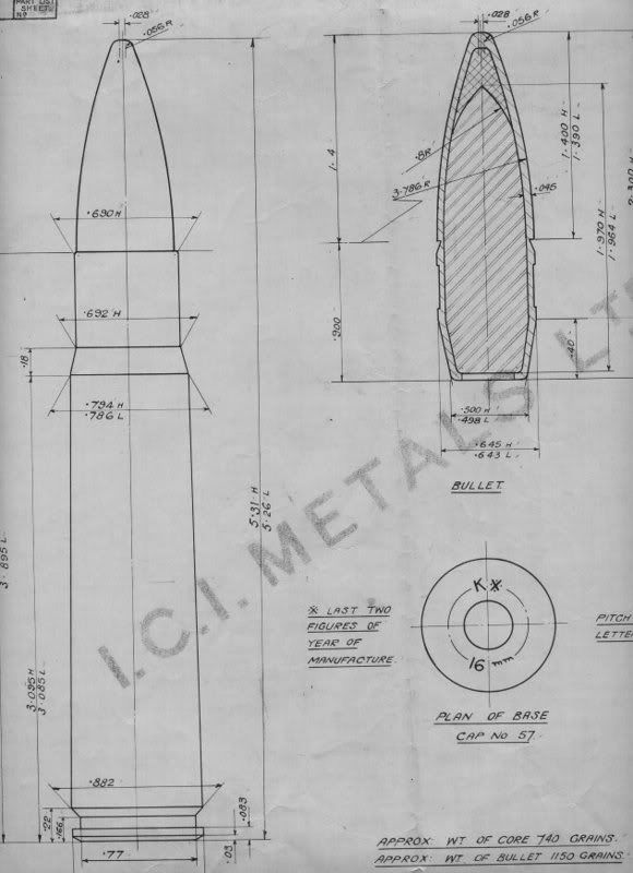

Incidentally, there was another Vickers HMG I missed from that list, and that was a 16mm gun which was in competition with the 15mm BESA. However, I can't recall offhand even seeing a photo of that round.

Here is a drawing of the 16mm Vickers, but like TonyW I have never seen one.
Whilst we are talking about little known British rounds, let us not forget the .5 BSA Observers gun, the 13.2mm BSA A/T rifle, the 13.5 x 104mm Kynoch MG, .8 Elswick, .9 EOC etc!

Interesting drawing. Were the guns / cartridges ever actually made or just designed?

Certainly the ammunition was made, as Kynoch made at least one batch in April 1938. I suspect another batch was made as the drawing I posted shows an amendment to the bullet envelope compared to a previous drawing I have.
I have no reason to believe that the gun was not made as it was certainly offered to the army as a tank MG, but in a quick search of the SAC Minutes I have I could not find it mentioned. However I do not have a complete set of SAC minutes or OB Procs.

So somewhere out there, there must be a complete 16mm Vickers cartridge, bullet or case. Would the pattern room have an example?

I don't know if the Pattern Room have an example of the gun, but I do not remember seeing one. It was a private Vickers initiative so they probably do not have one . I will check out of interest. I am sure they do not have a round.
