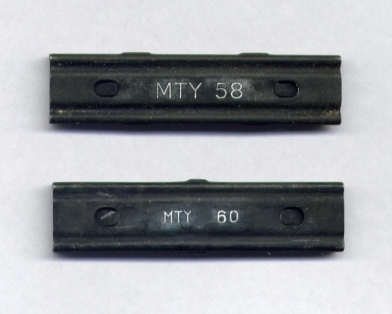

I have both the MTY 60 and an MTY 58 charger. Are they both chinese?

I would need to see the MTY 58 Clip to make an assessment of it. I do know of a Mk. 2 Charger (two stops on each side) marked "MTY 57" so the "MTY 58" could be real? How closely dose your "MTY 58" Charger match the "MTY 60" in the way its manufactured and the style of Font of the stamping?
Maybe the "MTY 60" clips are original British clips that the Chinese have reused? Without an original British MTY example to study and measure this clips will continue to stay as being a 'fake'. Certainly certain characteristics of the "MTY 60" doesn't match other British production Chargers.
If you can send me some pics of your "MTY 58" and "MTY 60" clips (one above the other) I will have a look and see what I can figure out.

I tried to scan these but with poor results, I will try again tomorrow. My MTY 58 is a Mark 2 (two stops) and the lettering is larger.
gravelbelly

Post 7.62x51mm chargers marked MTY 58 and MTY 60
NZ L1A1 Collector wrote:
I look forward to seeing your scans
OK, here are my scans. The MTY 58 is a Mark 2 type with two stop lugs on each side. The MTY 60 one is a Mark 3 type with a single stop lug on each side.
They are clearly very different, even the style of lettering is different.
gravelbelly

Thanks for the scan Gravebelly,
Well that certainly dose answer the question the "MTY 60" clips are 100% fake, not only is the font totally different you can also see the holes for retaining the spring are a lot smaller then the "MTY 58" example.
Even though I don't have the MTY examples I now have been told of a "MTY 57" and "MTY 58" Mk. 2 clips. It's very possible Mettoy never continued to produce any more chargers/stripper clips past the Mark 2 design.
The Mark 3 (single stop) Canadian design was accepted in 1960 as the standard for the ABC (Australia, Britain Canada) countries and formed the bases for the new NATO standard of stripper clips.
If you ever come across any other "MTY 57" or "MTY 58" chargers (or in fact anything not shown on the website) that are 'spares' I would love to do a trade to get examples I could measure and study for my research.
