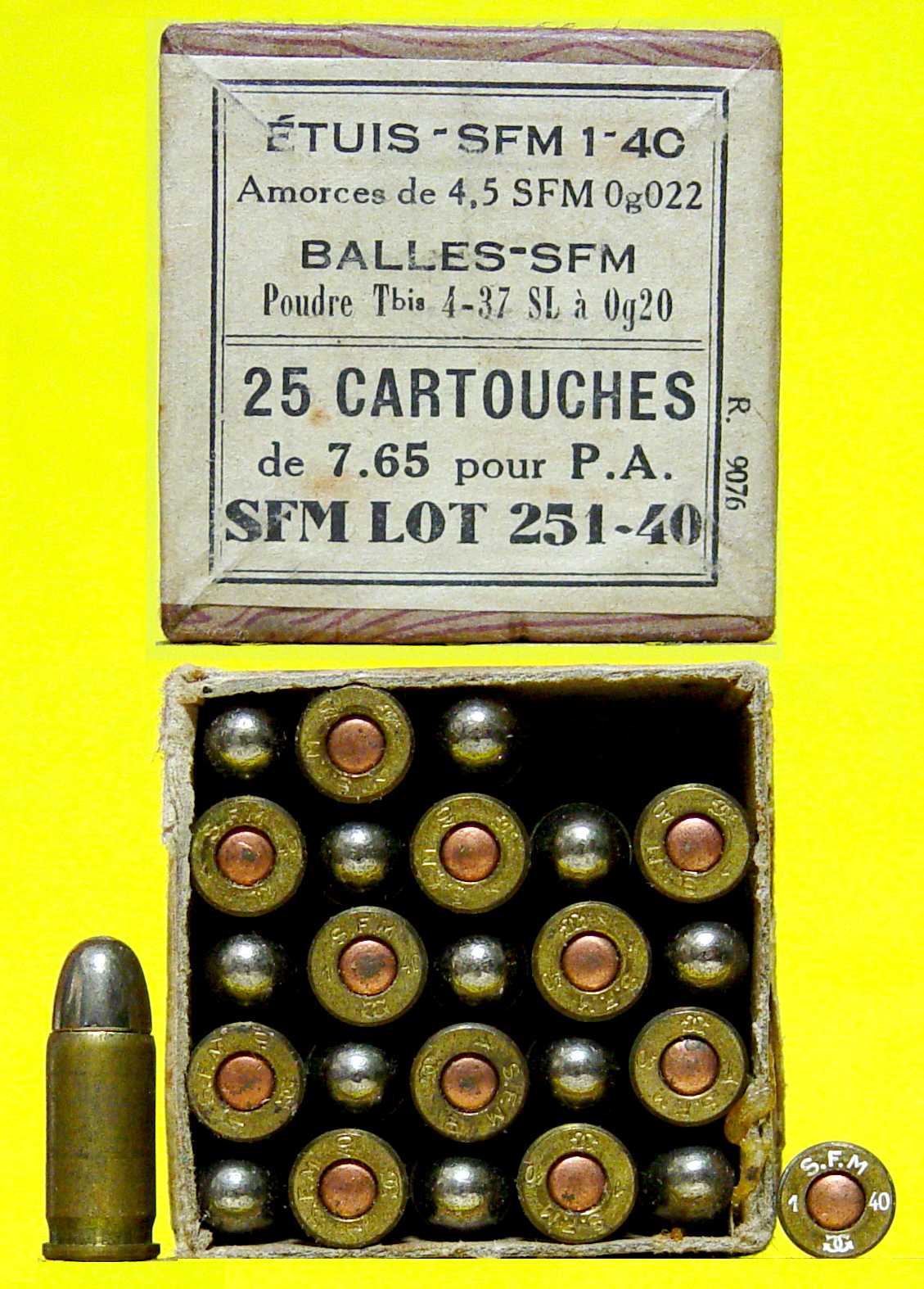

Here's a French example, for police or possibly military use.
