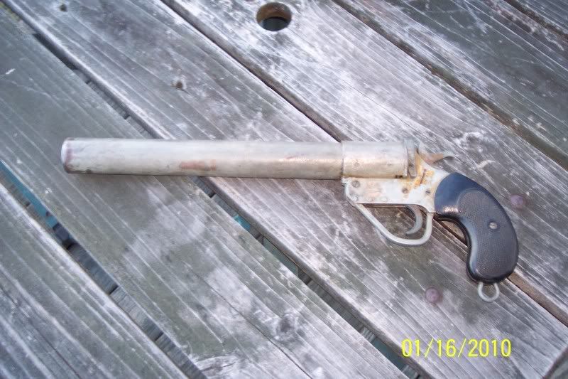

I just brought this one home. It has "crown, GR, crossed swords, P" faintly on top, "M601" on the hammer, serial on the barrel's left, and unreadable remnants of instruction stickers on top and left of the receiver, some warning about "this line". My take is it is a British Naval line thrower, don't know the calibre, but it is bigger than 12g. Does anyone know its name, what the warnings say, and what ammo/projectile it fired? Pics would be nice, or a website name.

Most of the line throwing guns, British ones at least, have a handle attached to the barrel. Still looking for a comparable example for a positive ID. If there are NO marks on the top of the barrel, "attachment" points, if you will, then this may have been a flare gun. Still searching.

OK, but most flare guns have short barrels since it does not matter where in the sky the flare goes.

Yes. And the line throwing guns I've seen so far have a larger diameter barrel. This one is an oddity, so far.

You gentlemen have very nice flare pistols but I still want to know why, with the existance of short barrel ones there was a need for a clumsy monster like than (imagine the holster!!)

Looks like a Schermuly line thrower. As stated most have a handle on top of the barrel. It uses the Webley breech action with a long barrel. It fired a large rocket which slipped over the barrel. Th e rocket was ignited by a 1" blank ctg.
This one appears to be built on the later stamped frame and they were also built on the machined brass frame.
