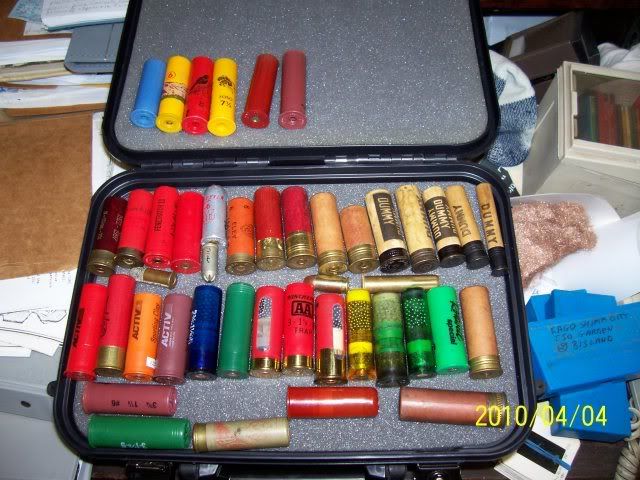

As you can see in this photo, I picked up quite a few of these all-plastic shells at SLICs. Most are ACTIV but there are Herter's, Wanda and Winchester made shells too. At the bottom is a loaded Winchester with an unusual rounded shoulder crimp. Guy posted another Winchester experimental all-plastic a couple of months ago that went into limited production for their Franchised Gun Club. I'm told by some very experienced collectors that there are over 1200 variations of the all-plastic shotshells but to the best of my knowledge, no one is offering them today.

Gourd, I have never fired a Wanda but I can certainly see where your experience with them would be justified. Like most things, not all plastics are the same! Wanda seems to be a hard and brittle plastic, like something a plastic drawer is made from. The shell is closed by the strange looking plug, not a crimp. I see many potential issues with these shells, not the least of which is the extractor issue of chipping out the rim. When I first saw one I sort of wondered "Why?".
Some of the others, like ACTIV and Winchester, used a more pliable plastic, like polyurethane I believe. They are more similar to the already accepted hulls used with metal heads which would lead, I think, to more acceptability by the shooting public. Wanda, on the otherhand, seemed a novilty.
In the picture above there are three transparent shells in the lower right, a yellow 20ga Wanda, a 12 ga and then a green 20ga Wanda. The 12 ga is supposedly a French shell but the only markings on it are four tiny stars on the primer. I need to figure out who made this one. The material is quite similar to the Wanda but the top closure has a paper patch over it so I can't really tell how its closed.
could you please put pictures (side and base) of this shell;
thanks
